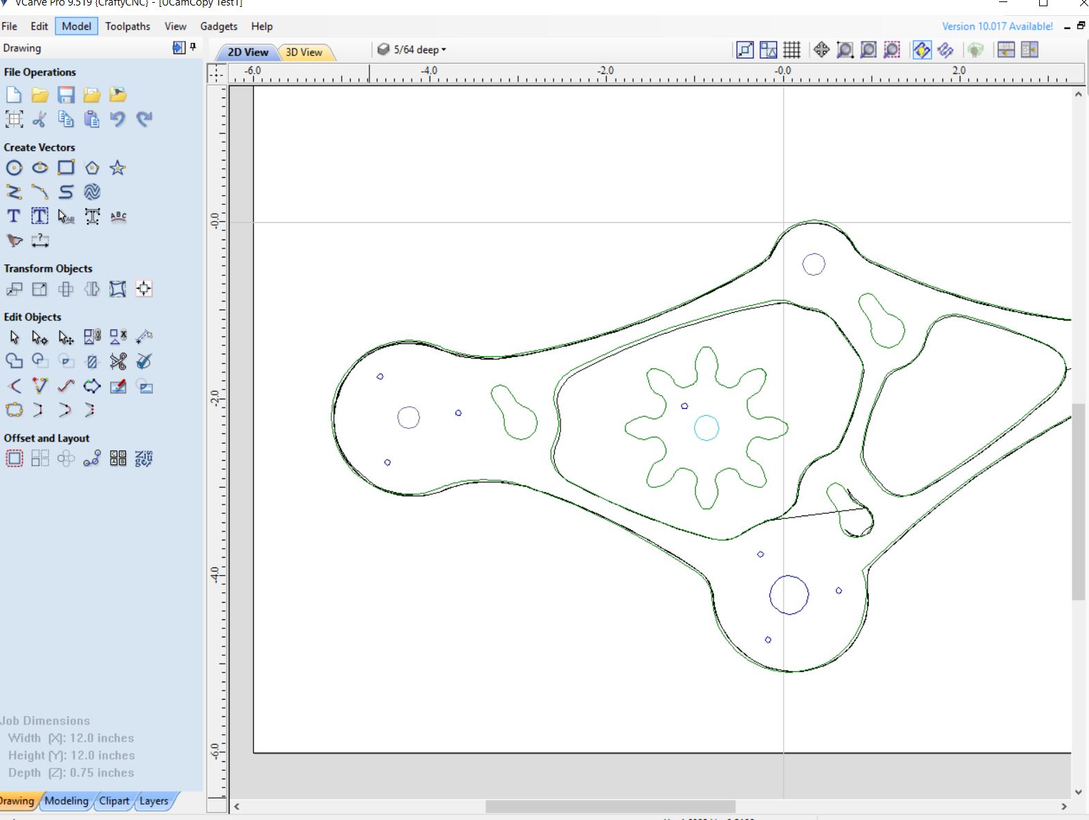

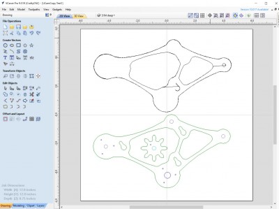

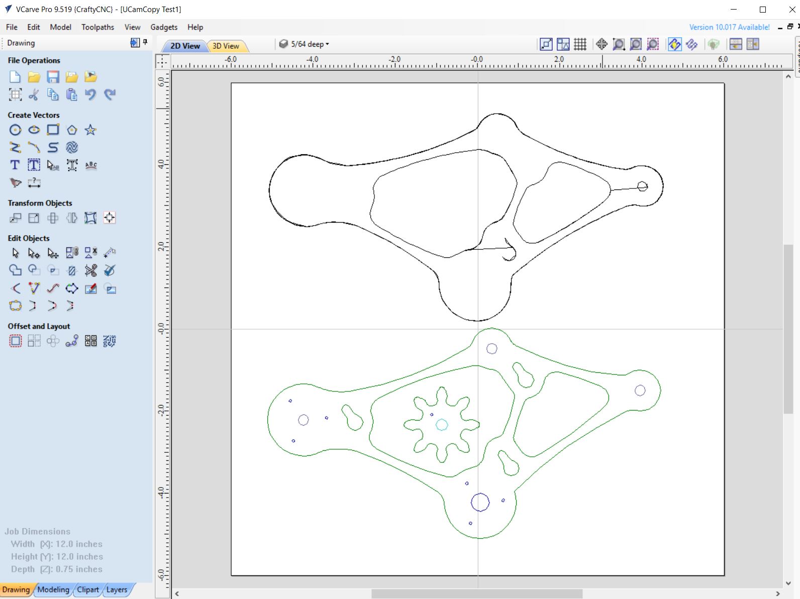

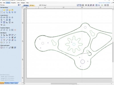

Postby eabrust » Wed Nov 27, 2019 3:16 am
Figured it may be fun to keep a running update as I work on this plugin, now to be known as UCamCopy (thanks Rob and Tweakie). Feel free to have a dialog and ask questions about how things work or how I did things if you are curious and want to start creating plugins. I'm not a programmer, and definitely not qualified to teach anyone anything about programming, so it could make it fun :)
Over the last few days, and much angry head scratching I finally fixed an error that was preventing the plugin from completing a full lap around parts.... thanks ATAN2.... :roll: After fixxing that, I've since added in some point sampling at regular distance intervals to dump data points to a comma separated text file, and added two more PID loops to try and keep the target on track (total of 4 PID loops running concurrently, who's output drives the X and Y axis velocity).
So here's the first test output: I had a really good comparison part to do a test with, since I had the original geometry in VCarve, and I had previously cut the part on this router. Here's that first part scanned with the plugin, dumped out to a CSV file, and imported back into vcarve (thanks Paul Rountree for the CSV plugin!), and layed back over the part for comparison. I let it make about 3 laps around the outer perimeter while playing with tuning and speed to see how repeatable it was. PS. Bonus points if anyone knows what this part is from, or has made one (hint, search out Derek Hugger for a some fascinating things...).
I'm pretty happy, considering the comparison includes any errors of both the measurement, and the original cutting, plus deviations from shadows, etc.. I also haven't really spent time making sure the camera is absolutely vertical, etc.
Here's a question for Scanything users, what sort of speed can you scan at? This was run between 5 to 10 inch per minute, which sort of sounds slow except the machine really can't 'see' very far ahead, so I don't think in reality I could go much faster with the current camera setup and stay on track.
