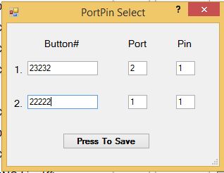

This plugin will activate a Pin with a toggle button easily created in UCCNC, this will also work with Estop engaged where a macro alone won't work. I originally written this by a request in a thread and uploaded for others similar to his needs. There are other good solutions in thread to accomplish this but thought this my be appealing to the less savvy macro users.
Thread can be found here>>>>>>>>>>> viewtopic.php?f=11&t=855
Instructions are simple and below:
1. Create a toggle button in screen edit and give it a button #.
2. Put PortPin plugin in plugin folder.
3. Go to configure for plugin and check startup and enable.
4. Fill in toggle # of toggle you created and port & pin to manual control and press save.
The attachment PortPin.JPG is no longer available
Hope someone may find use and can download from link below.

Postby Dan911 » Sun Mar 25, 2018 1:22 pm
For those who contacted me with problems...The only problem is my lack of instructions.
You have the options to setup 2 buttons for two different port/pin. You cannot set up using same button for 2 different port/pin,
or you can't have two different buttons controlling same port/pin.
Updated Plugin to not allow this followed with a warning window.
This version plugin was created with .Net4 and will only work with .Net4 UCCNC versions.
I also updated plugin so can be called with a macro or hotkey but you will lose the ability to call in Estop with these options.
