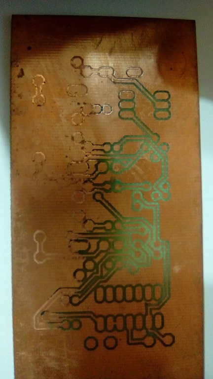

P.S.:
- The photo is about the first attempt to produce a double side PCB.
- The plugin and macro activity is an exercise to better understand the manual "UCCNC Version 1.2022" and the operation of the UCCNC SW itself. So I will try to use everything to learn. Until now, everything has not gone well. I've had trouble with some exec and etc commands.
