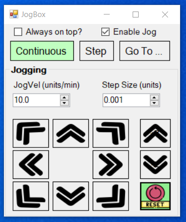

Postby eabrust » Sat Feb 26, 2022 1:40 am
I put a small 'jog panel' plugin on Git here: https://github.com/CraftyCNC/JogBox-for-UCCNC
I added 'snap to desktop edges', cleaned it up a little, and its fair game to use or modify as you wish.
Pre-compiled and ready to use plugin attached:
JogBox.zip
(214.39 KiB) Downloaded 665 times
