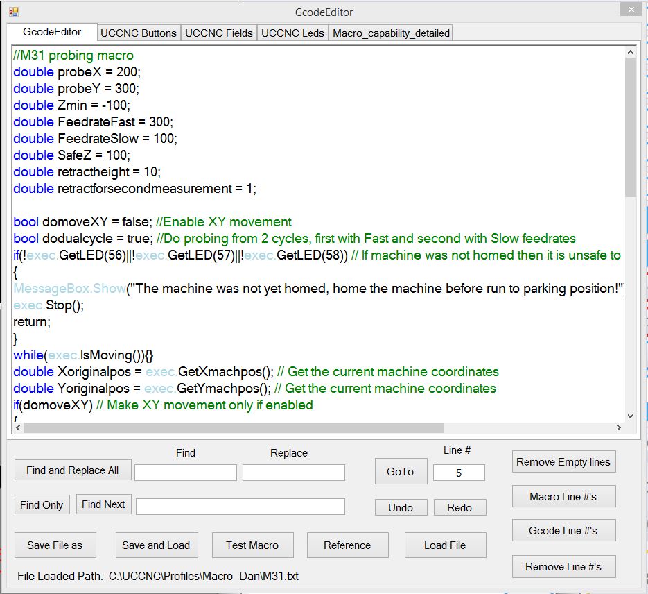

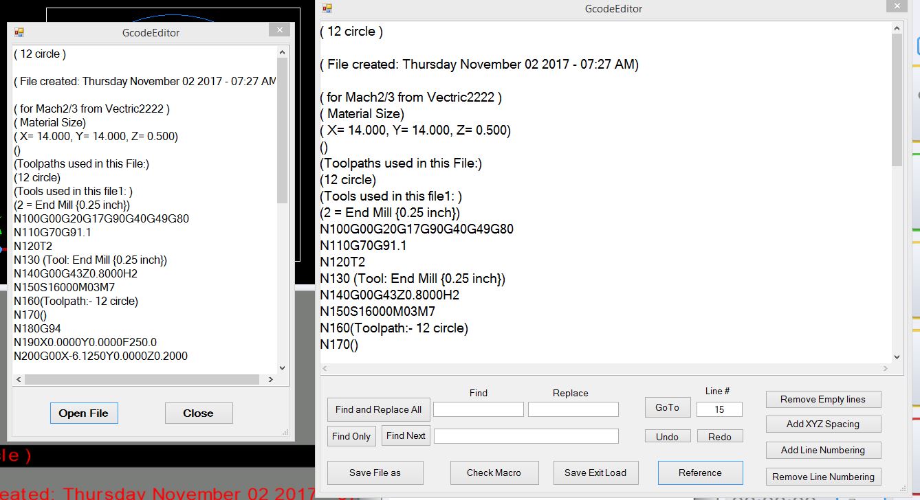

Postby Dan911 » Sun Nov 11, 2018 4:52 pm

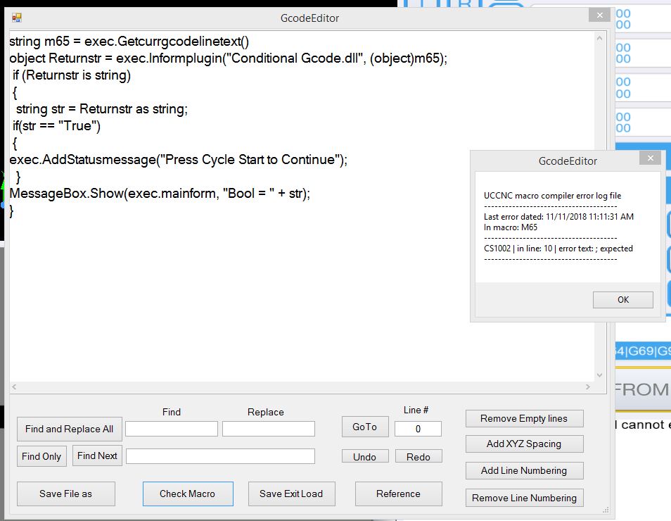

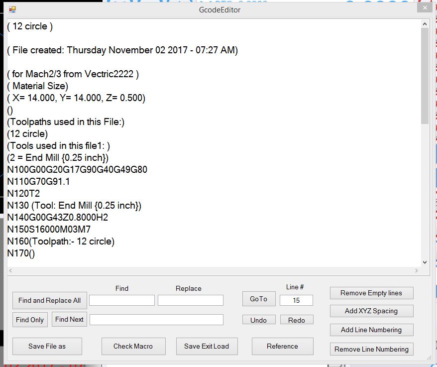

Hi Terry,
I started a thread here because it didn't seem appropriate to discuss and post test plugins in the toolbox section. I took another whirl at this this morning, I didn't like the interface of the original trying to add 3 windows on 1 form. Went back to your first idea using a button to call reference window to copy and paste to your editing gcode or macro. I also added a Macro Check to quickly check and edit a macro, it will put UCCNC in Offline mode while checking. I didn't add tabbing yet because this will be last thing to do so I don't have to redo on changes, there's still a lot left to be done and tweaked. LMK what you think!
To test
create a button or hotkey with # 7777
A file needs to be loaded in UCCNC to use
Load macro same as you would Gcode, macro WON"T be viewed in UCCNC codeviewer but will in editor.
Test.zip
(8.02 KiB) Downloaded 1254 times

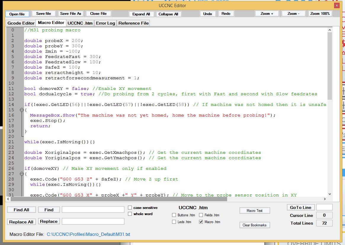

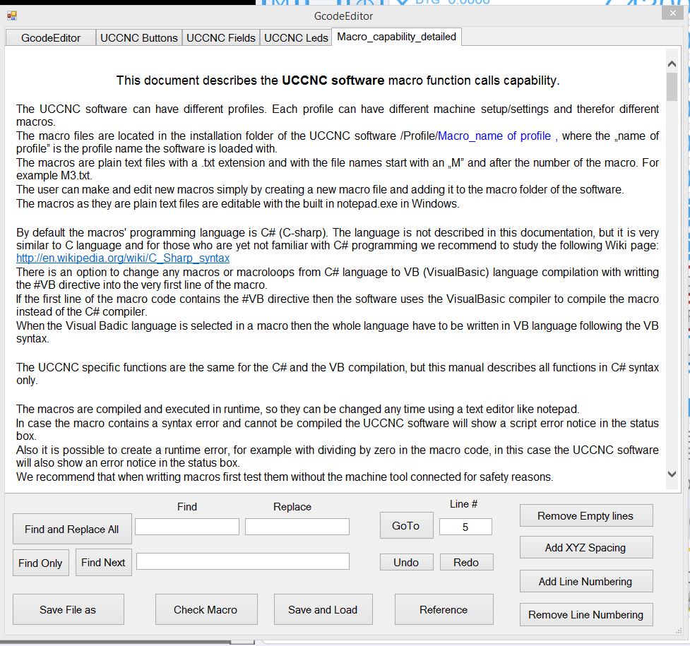

Postby Dan911 » Thu Jan 17, 2019 1:59 pm

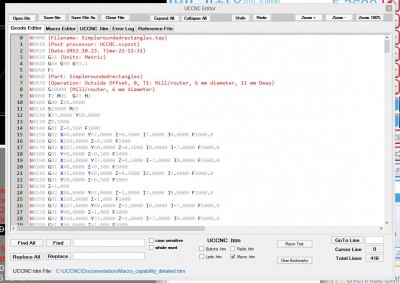

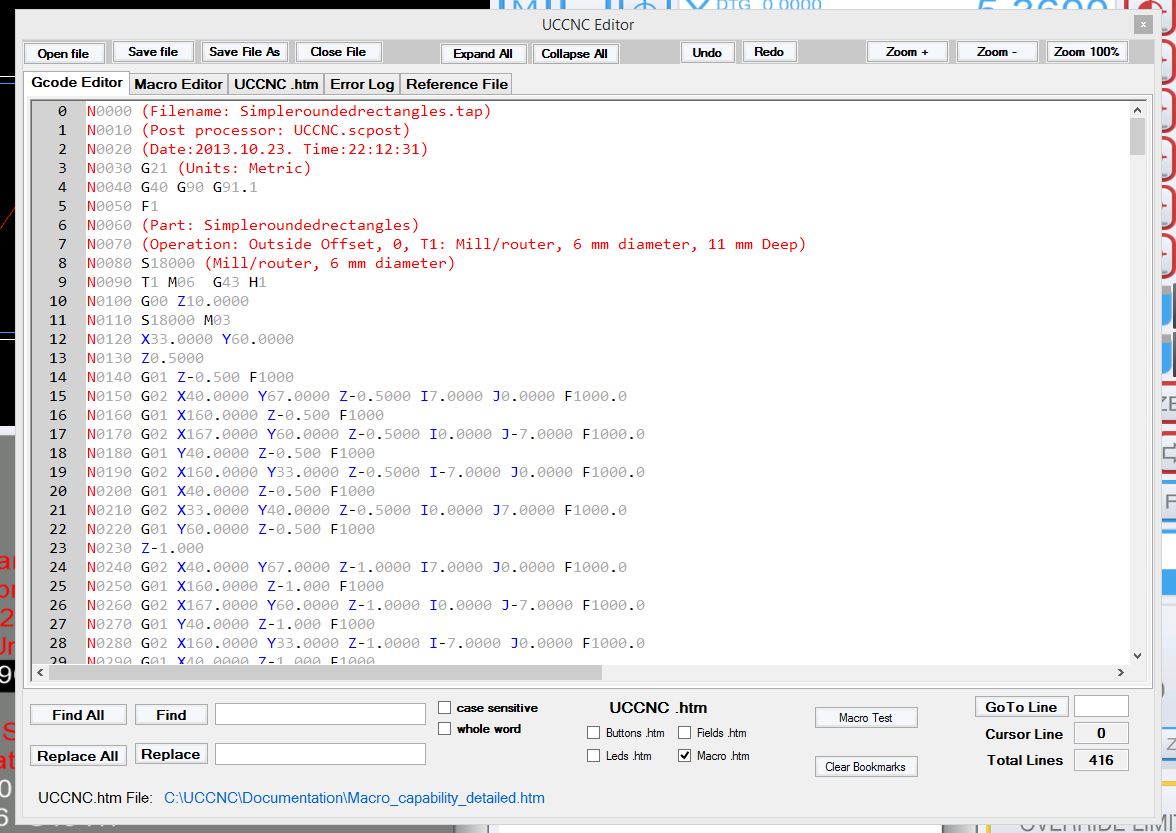

I been using a editor plugin that uses the same text editing component (Scintilla) as Notepad++, thanks to jacobslusser it now can be used in Net framework and made it possible to create this plugin.
The plugin has 5 window tabs and will open with the Gcode Editor tab and load whatever gcode file is loaded in UCCNC, if the file is edited and saved it will reload it in UCCNC. The same why the editor works supplied with UCCNC. The plugin uses 2 lexer/styles, Gcode lexer for Gcode Editor and Cpp/UCCNC for Macro Editor.
You can open a file and will load in the tabbed window that's active(open).
The Macro Editor has a few more added features such as...
1. Code Folding
2. Bookmarks
3. Brace matching
4. Auto Complete
5. Macro Test
To use Macro test the Macro file has to have the correct Macro format M#### and exist in your profile macro folder. If there's and error on test it will add a bookmark to line with error, you can also look in
error log tab to see error. UCCNC is put in offline mode while testing macro.
The UCCNC.htm, Error Log and Reference tabs are read only windows, the Reference Tab when open can open a file and be copied from to paste in the Gcode or Macro windows. The lexer/stylers are set to my preference, If I see an interested or request I will add a preference window to edit styles.
The Zip has 2 files.
1. Gcode_Macro Editor (this in UCCNC plugin folder)
2. ScintillaNET (this in your UCCNC folder)
****WARNING do not enable this plugin without the ScintillaNET.dll in UCCNC directory or will cause a error on UCCNC start up!****
This will only work in Net.4 UCCNC test versions
To use create a button with #5411 or Hotkey with function #5411 or change your edit button from 126 to 5411
Editor12.zip
(1.21 MiB) Downloaded 1296 times

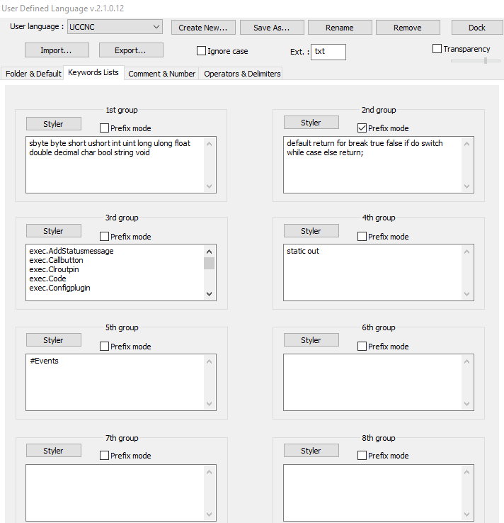

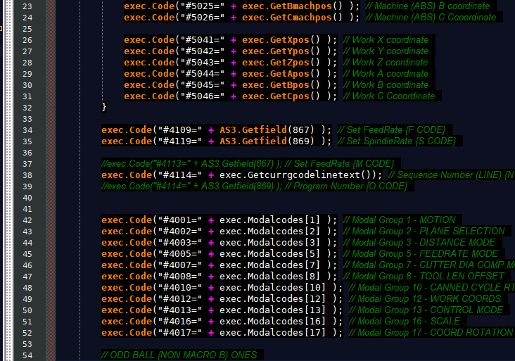

Postby Robertspark » Thu Jan 17, 2019 9:47 pm
Dan,
Any chance of being able to customise the notepad++ front end / interface to change the colours (background + functions etc)
Also is there an ability to add functions (methods) to the plugin so that they are highlighted.
Keywords lists
Good work on the plugin, thanks
Re: GcodeEditor
Postby Dan911 » Fri Jan 18, 2019 12:38 am
Robertspark wrote:Dan,
Keywords lists
Functions are needed for different languages that Scintilla(Notepad++) didn't have a lexer for, for example there really isn't a c# lexer they all stem from the cpp lexer. I already added functions needed in the macro editor lexer and gcode lexer so adding functions is probably something I won't do because not needed. If a function is missing/needed that I missed for C# or UCCNC macro I will certainly add.
To be able to add and remove Keywords, Autocomplete words and change styling colors would be very simple and mentioned in previous post, if I see this is of interest or receive a few request I would do.
Thanks for the Notepad++ pics :? never a big fan of the black backcolor.
