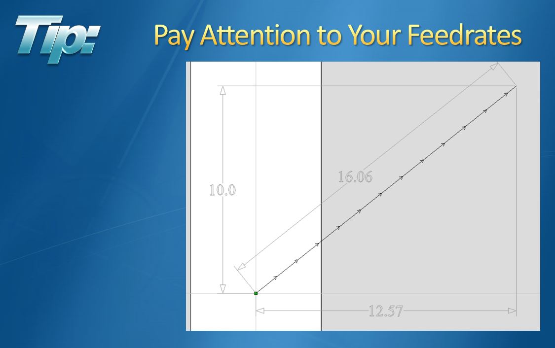

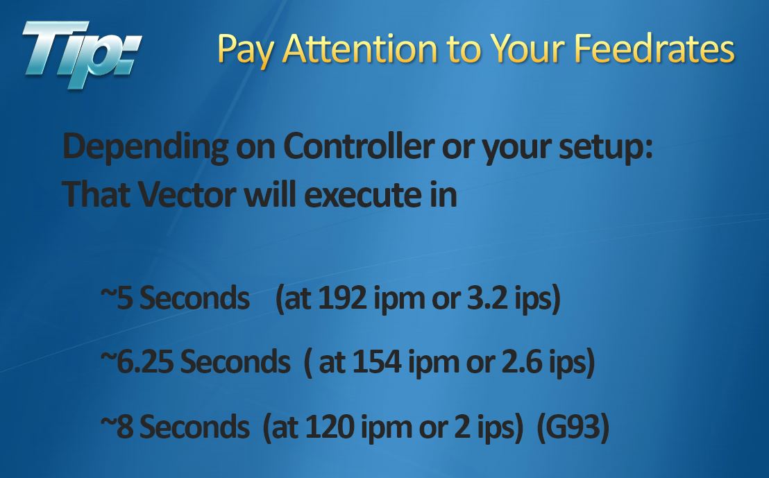

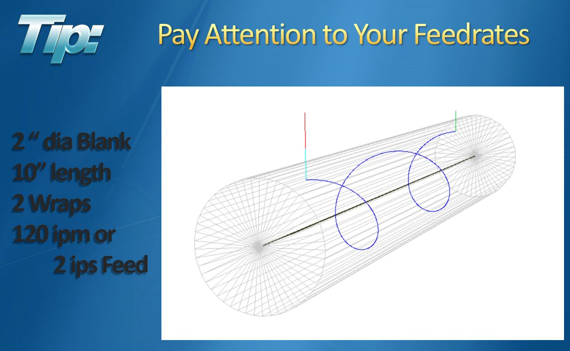

IF implemented, G93 may be the only "support for rotary axes" that you would need to provide to gain seats for those that have rotary axes. I just did a rotary presentation that might explain why it is needed. (Assumes CAD postp will output inverse time feeds)
