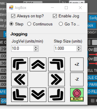

Postby eabrust » Sun Feb 06, 2022 5:21 pm
How about a floating jog panel plugin? I prefer working w/ plugins vs screenset alterations and macros.
I had made this as a demo a while ago as a plugin example. I added diagonal jog buttons pretty quickly today. It could use more work/refinement, but I won't put more time into it if no one will use it.
JogBox.zip
(113.93 KiB) Downloaded 593 times
Just drop it in your plugins folder, enable to show on startup. I can clean it up and make the source available if there is any interest in it.

Postby johnsattuk » Sun Feb 06, 2022 5:27 pm
Will give it a go :D :D
