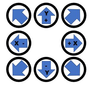

Hello UCCNC Team,
hereby i would like to request also diagonal movement button beside only up/down and left/right.
Lot of other CNC control SW have such diagonal movement buttons and i was using this "feature" a lot.
I reallly think this would be great improvement for UCCNC and it will provide additional functionality compared to CNC wheel.
Would be great if this would be implemented in near future.
Chris

Postby ger21 » Sat Feb 05, 2022 2:13 pm
There's no easy way to do it on the screen.
Easy to do with the keyboard or external buttons.

I see this option: make a diagonal macro. For example:
G91
G1 x10 y10
G90
only instead of ready-made values, consider the distance set for jog, and add a check at the beginning that the final coordinate will not exceed the limit of the axes.

Postby cncdrive » Sun Feb 06, 2022 5:25 pm
I've just tried to implement this, but it is unfortunately not possible on the UCCNC application side.
The problem is that the axes are started and stopped one by one using the jogon and jogoff function of the motion control API.
So, the issue is that the axes cannot be started and stopped in the exact same time.
I've just tested it and there is often a little coordinate difference after a diagonal stop. :(
So, to implement this properly we will have to make some changes in the API which will take some time for sure, sorry.
Re: Diagonal movement button
Postby cncdrive » Sun Feb 06, 2022 5:29 pm
In other words you can make diagonal jogging to work, but it will be not perfect.
