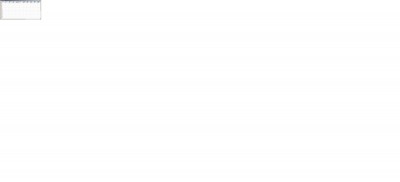

Postby Battwell » Wed Jun 05, 2019 3:22 pm
that image comes up too small to see terry.

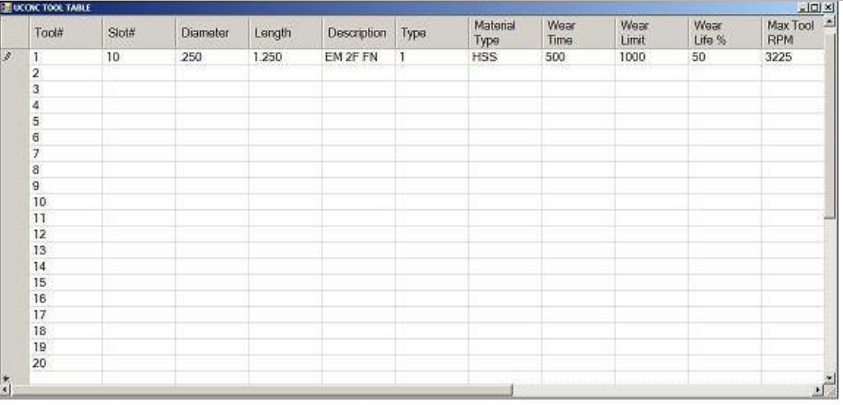

Postby Robertspark » Wed Jun 05, 2019 3:27 pm
this may look better, zoomed in and re-screenshot
