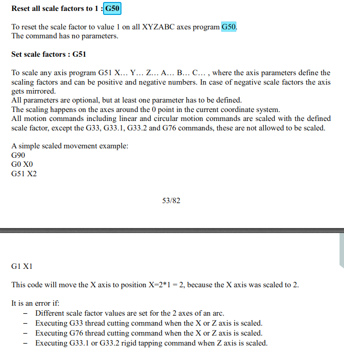

What do G50/G51 do? They are not listed in the manual.
Re: G21 + G20 checkbox / LED
Postby Robertspark » Fri Oct 27, 2017 1:18 pm
Gerry,
They are in the manual, just you need to look in the one in the development version documentation folder (your screenset won't have them because they were newer than your screenset) [you have the same problem that everyone else has with a custom screenset not being able to easiliy keep up with the development version functions (added LED's etc)
screenshot of manual below

Postby cncdrive » Fri Oct 27, 2017 3:11 pm
Gerry is right, that making the G20/G21 work like a macro would be very hard to impossible.
The G20/21 is just as hard to implement as easy it looks. I know because it works very similar to G50/51, just while G51/G51 works with setable ratio the G20/21 works with a fixed ratio.
G20/21 also introduced another issue that if there are fixed setable units of mm and inches then the base unit also have to be clearly defined,
and this is because if the base unit (the steps per and others) are unitless then you can't make a conversion, because you don't know what the base unit is.
And G20/21 requires a continous back and forth calculation of coordinates just like the G50/G51, because these g-codes can be programmed any time, not only on the beginning of the g-code, but anywhere in the g-code is why it is not as easy as it looks for first sight.
So, these g-codes are really not as easy as they look.
I could call a macro with the G20/21, it would not be a problem to implement that, but I think implementing G20/G21 in a macro very far from easy, so the question is if it would do any good if I implement it...
