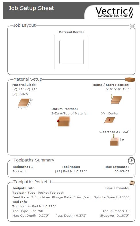

Sword wrote:I haven't tried this yet, but just a thought I had when first reading it. Vectric products can save a 'Job Sheet' in html format.... Could this somehow look for this file and if present, open it for viewing? Would be kind of nice if it opened in a stand alone window instead of a browser in this case. Possibly adding a line to your PostP file that would ask if you would like to see it or not when loading a file. Just some thoughts on making use of this. ;)
What kind of html is it? Does it contain pictures or just a description? Is is a fixed file name or the same as the g-code?

Hi Dezsoe,
It can be any name, but generally the same as the design file like 'New_Summary.html' It's basically a web page and looks like this.

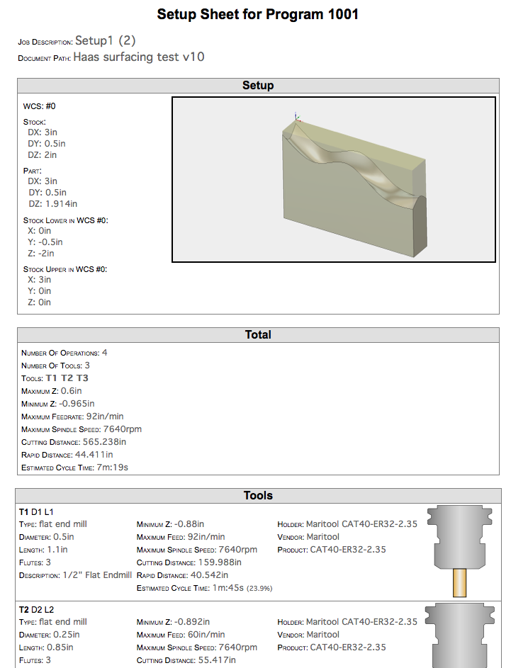

Here is a look at the setup sheet created By Fusion 360:
When I generate my gcode, Fusion creates automatically the same image shown in the top right corner of this setup sheet showing the placement of the work offset and the stock in transparent around the part.
The image is named the same as the gcode file.

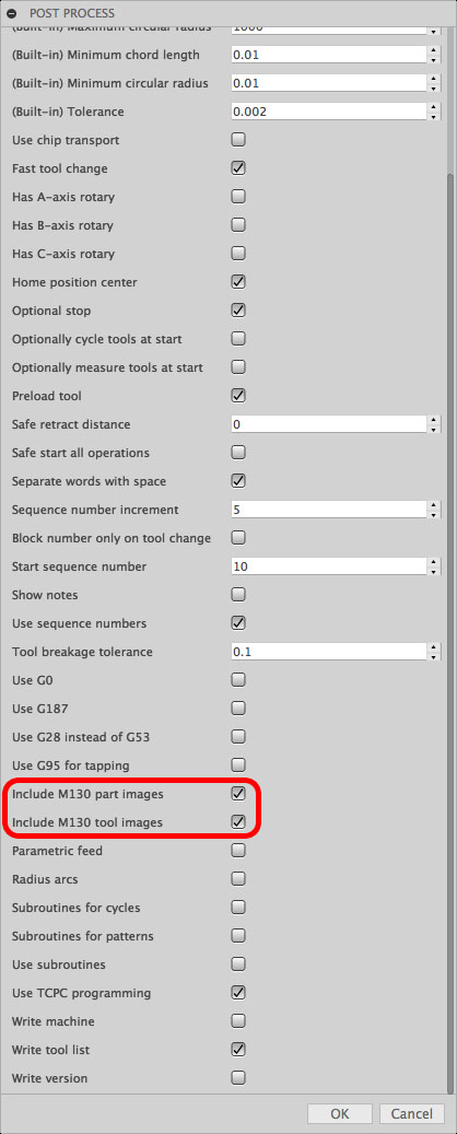

Fusion also has the option of generating tool image and linking them in the gcode with M130 before each tool change! But I haven't managed to have Fusion generate the tool images and I don't know how. Images aren't generated but M130 is present for the tools.
The part is working!

Blaise wrote:Here is a look at the setup sheet created By Fusion 360:
