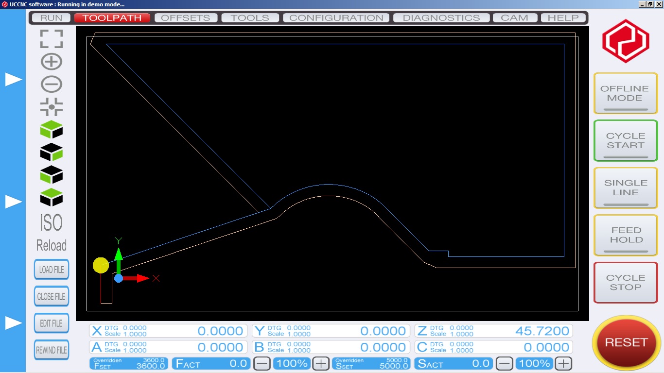

ive tested a square!
i like the warnings page.
i had to read the manual :-)
it doesnt work quite the way im used to re lead ins etc. a bit strange having to lead in with a line in the same direction- i m used to leading in at 45 degrees angle
but then the first offset it then offsets in both x and y so would leave a small un machined nib.

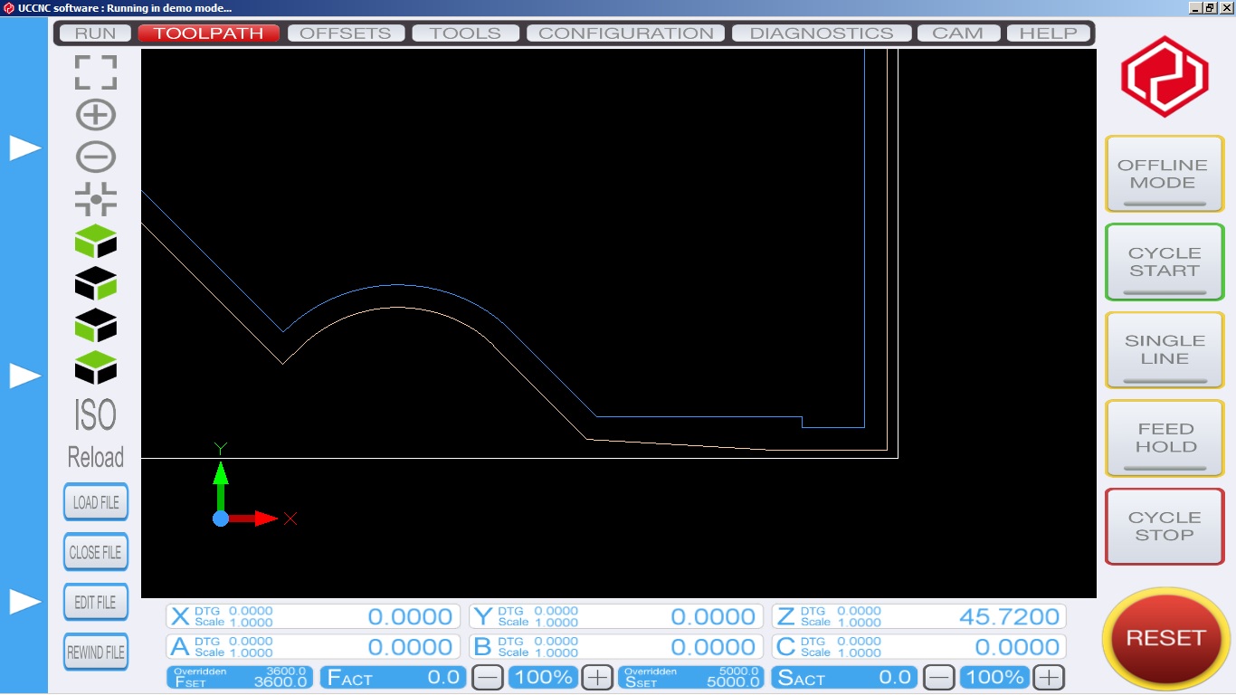

tested it on the piece i would be making with it (dxf i sent for testing) while it doesnt gouge-as mach3 does etc. it throws a warning for that point and ignores it-
so the outside profile wouldnt be correct :-(

Postby Battwell » Sat Dec 23, 2017 2:20 pm
Posts: 885
Re: Cutter Radius Compensation ( G40 , G41 , G42 )
Postby Battwell » Sat Dec 23, 2017 2:44 pm
i tried lengthening one segment to way over tool diameter- but still no joy-

i compd with a lead in/out on both attempts. in the second id zoomed in more to show the missed segment- which turns into a ramp between points it couldnt calculate.
i had imported the on line code from vectric and manually added the leads.
this will be an issue if there is a small segment off the main line.- but at least it doesnt attempt and gouge like mach3 does ;-)
this has shown up in every "hobby control" i have tried. linux, dynamotion, mach etc- by that i mean not big oem manufacturer controls.
radius offsetting is going to be a very hard one to get "perfect" as balacz says- there are just too many variables.
