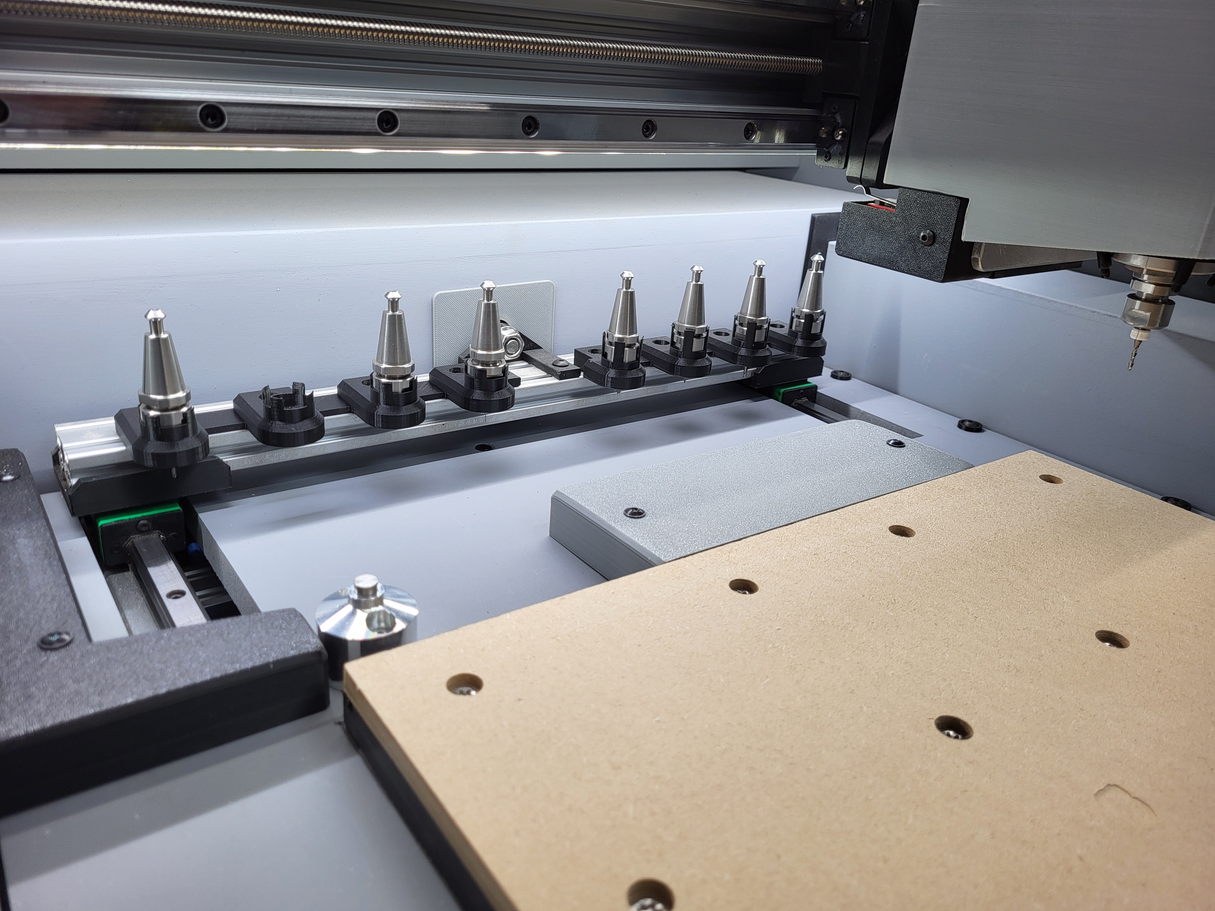

Postby krsykes23 » Mon Feb 17, 2025 6:06 pm
I have literally justfinished building a new CNC with an 8 position ATC. The toolrack is mounted on dual linear rails and is actuated by an air cylinder, which is operated by a two-way 24v air solenoid.
This solenoid is connected to Pin 6/Port 1, which is defined in my M6 macro as...
int ToolRackport = 1;
int ToolRackpin = 6;
exec.Setoutpin(ToolRackport, ToolRackpin); // Push ToolRack forward
exec.Wait(1000); // Wait 1 sec
exec.Clroutpin(ToolRackport, ToolRackpin); // Push ToolRack backwards
I'm certainly no expert on this, but was surprised when it worked!
