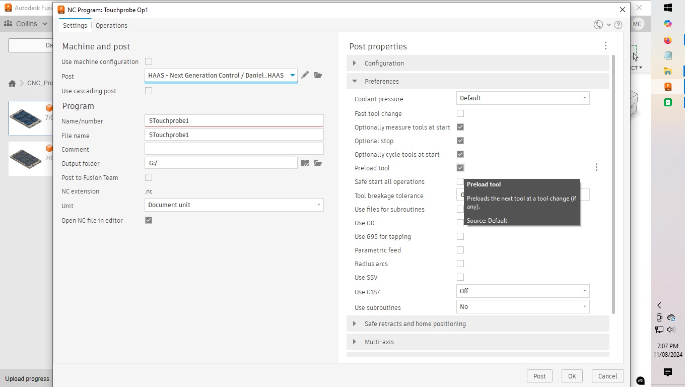

Postby Doncis » Fri Aug 09, 2024 12:48 pm
After M6 tool change, I want to prepare next tool slot for next tool change. How to get next M6 tool number on existing Gcode?

You would need to get your post processor to call a macro that would stage the next tool , the HASS post processor does this as a option.

haas post processor using what cam software?
Re: Prepare next M6 tool change
Postby Delco » Sun Aug 11, 2024 9:11 am
Yes , it runs a hass Mcode to prestage the tool.

Thanks. Now I able to get next tool number.
