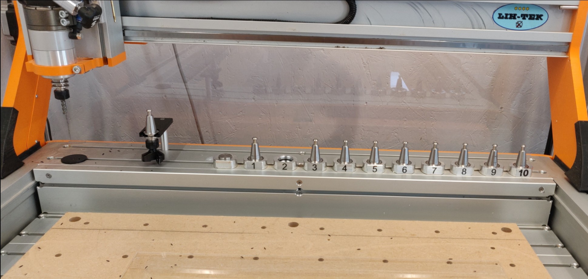

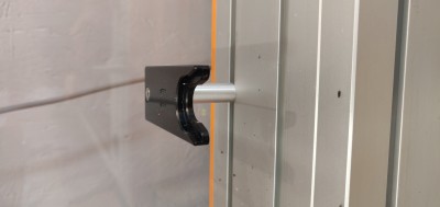

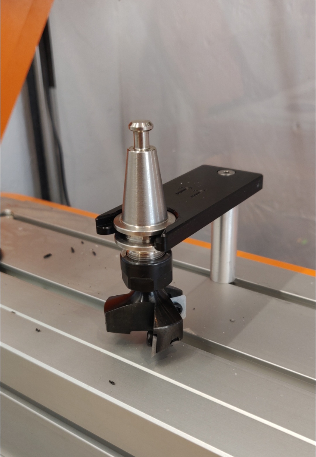

Here is some pictures of the machine with the tool holder for tool 11
