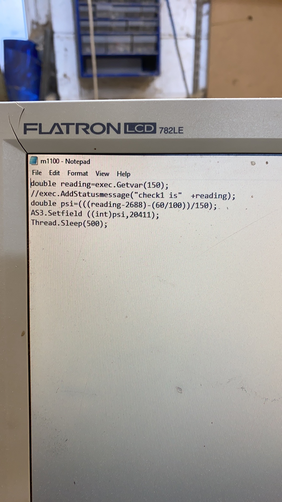

I fitted an air transducer to my machine that outputs analog between 0.5v to 4.5v
Analog in in 0 to 10v
Gauge reads 0 to 150 psi
Code took me a while to work out but is very simple
A video of it working is in what you have made section
