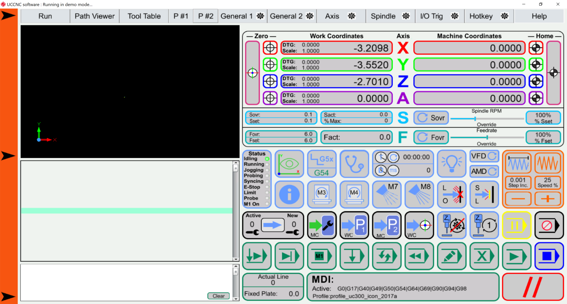

Thank you all for taking the time to reply to my question about tooltip capability. I understand your replies. I do not have a serious need for the capability, but thought if it were possible, I might use it in a limited way on a new Run screen I'm working on. I am prototyping a Run screen that is heavily based on Icon buttons rather than text label buttons. I don't know if I will adopt the Icon based screen for daily use, but I want to see if a structured, matrix oriented screen layout makes sense for me, particularly when using a touch screen. Attached is a "work in progress" screen shot.

Postby dezsoe » Fri Feb 22, 2019 11:55 am
It looks very nice! I have an idea to make the tooltip, I'll try it on the weekend.
