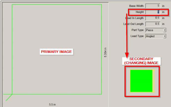

..... my long term plan of emulating the following / something similar ...

YES!!!! it works!!!!!
Hover over, tab to, select and deselect "start angle" and "hole depth"
Nope not one of my macro wizards.... just edited one of Terrys
