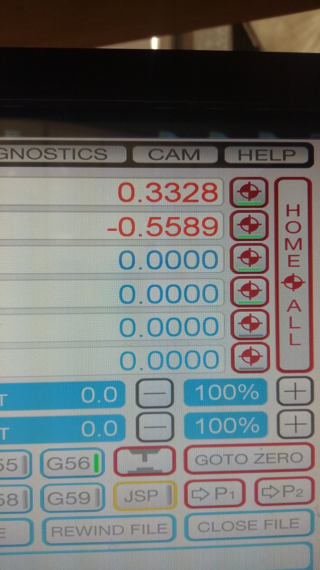

Postby tracar » Tue Dec 04, 2018 12:53 am
File works great with stock tool probe script. Thankyou
What causes the x and y. To turn red like this?

Re: M6
Postby tracar » Tue Dec 04, 2018 5:31 am
so how can this file be changed to put it back to the original NoN G68 non red dro on return from tool change probe.
i have included my last working file M6 i added this : exec.Code( "G69 " );
is there a better way to rewrite or add this change ?
i mean the dro's still change red, but go back to normal color just before the cut
M6.txt
(4.04 KiB) Downloaded 946 times

Postby Robertspark » Tue Dec 04, 2018 10:15 am
here you go
Seems to work ok (please test it first though with and without G68)....
