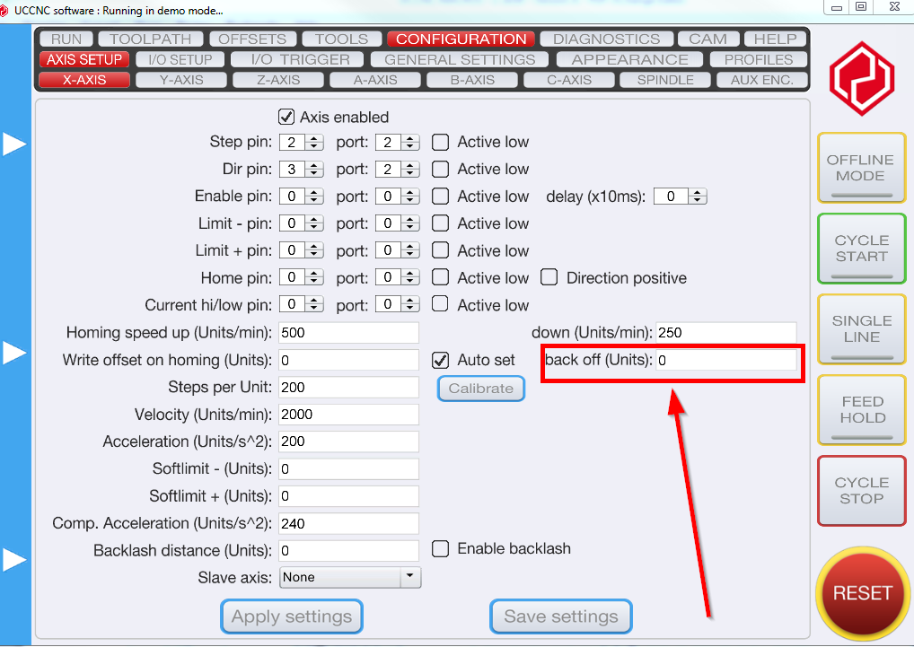

With regards to Backoff, this is set on the Configuration >> Axis Setup >> X,Y,Z,A,B,C axis (about mid page)
