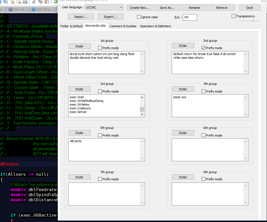

One thing that I've done since is added in a few of the other standard functions that I use a lot + have been added items such as #Events
Screenshot attached
And some of the math + convert functions that i use
https://msdn.microsoft.com/en-us/librar ... s(v=vs.110).aspx
note there are a few newer methods (functions) that have been added to uccnc since I did that originally... hence go through the index on my uccnc macro manual and check you have everything listed.
I'll have a go at updating it sometime (didn't think anyone was using it)
2017-12-08 22_35_57-_C__UCCNC_Profiles_Macro_Default_M70.txt - Notepad++.png
