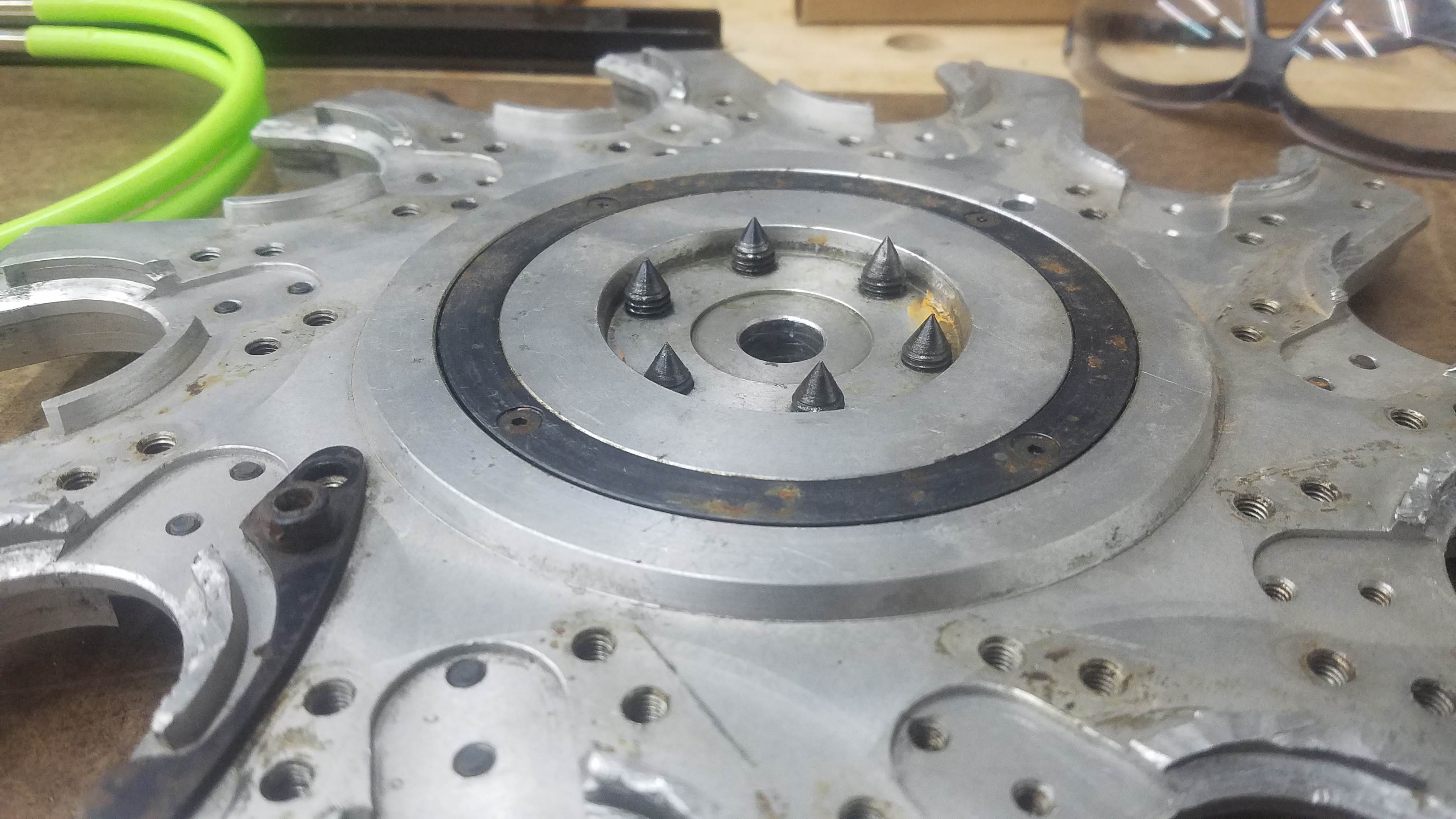

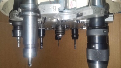

Some photos of the carousel construction.
Sensors at the top
Belleville washers below, with the platter mounted on 6 points that allow the platter to be initially adjusted level, then the belleville washers allow the platter to move up or down if the drawbar gets stuck open or closed, triggering one of the sensors.
mounting points
belleville washers
sensors
