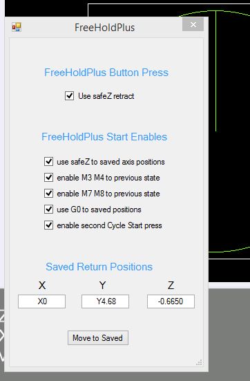

The FreeHoldPlus plugin I been developing now does this, I created a routine suggested by Robertspark in this thread that converts the G91 Gcode to
G90 coordinates. It is not possible and mentioned somewhere in this thread to bring back to Stop() postion XYcoordinates in G91 due to UCCNC internal coding but will bring back to start position of Gcode line it was Stop() in. (Thanks Robert!).
G90 will bring back to where stopped after jogging/moving from stopped coordinates and continue with Gcode file.
G91 will bring back to Gcode line start after jogging/moving from stopped coordinates and continue with Gcode file.
Will upload to UCCNC Toolbox after more testing tweaking but any1 interested in testing PM Email.
